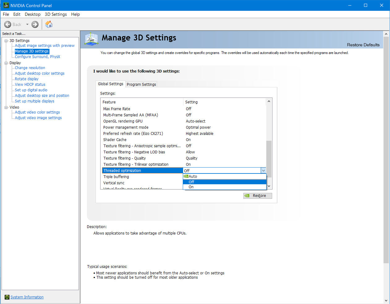

I found a solution to this problem. It's probably specific to nVidia. If you experience this, change this setting in "nVidia Control Panel" to "Off":
Screenshot 2023-02-08 101240.png (88.43 KiB) Viewed 45168 times
It seems to fix or workaround the problem in all Heli-X versions.
