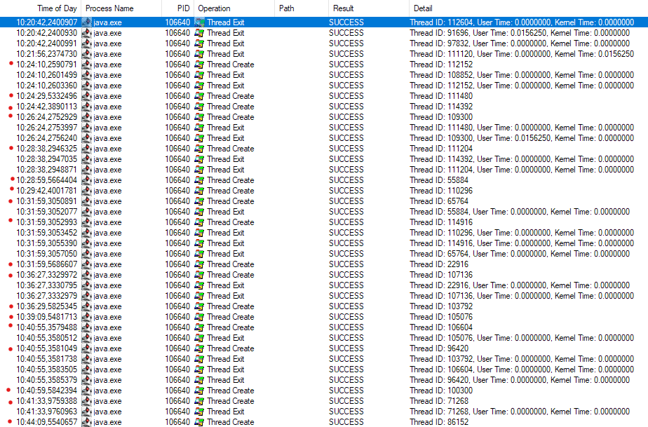

I made a bit of investigation. I ran Process Monitor because I thought that these "glitches" happen because maybe Heli-X loads some files, like sounds or whatever. Especially because they happen more often right after you start it, and it gets more stable after a couple of minutes.
I didn't find any of that, but anytime a "glitch" (it freezes for a couple of frames) happened, there was "Thread Create" operation logged in Process Monitor.
Not every "Thread Create" resulted in a freeze. But every freeze resulted in "Thread Create" being logged.

Sorry for spamming, but I have more insight.
First of all, this is how it looks over time, just to have idea how often things happen. Every "Thread Create" was connected to FPS drop.

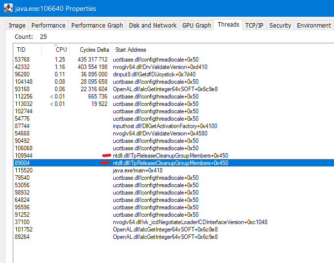

I was able to record thread activity and it seems anytime this happens, there's thread creation / destroying around these two:
If I suspend these threads, it seems problem is gone. I will test over time, but I was running Heli-X for 15 minutes with no FPS drop and no new "Thread Created" events in process monitor. And before it never happened that it would run 5 minutes without a problem.
This is a workaround of course and maybe introduces some problems, not sure yet. I don't have time to research more at the moment, will research later..

Not a lot of new knowledge, but I can say now with confidence that suspending "TpReleaseCleanupGroupMembers" threads on Heli-X makes Heli-X run smooth.
Also, what this function is doing is release a thread pool (Tp = thread pool).
I haven't found a way to automate this yet, so I do this manually anytime I start Heli-X.
Why would the process release a thread pool every couple of minutes - this looks wrong. Not sure if it's a problem in Java, or some library, no idea.
