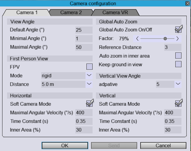

Good afternoon!
I have troubles configuring camera.

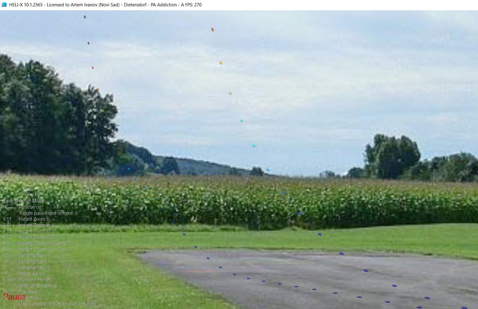

I want it to be soft (model mofing on a screen and not tied to the center, to feel the movement) and to have zoom. But with the configuration I have the plane just flies away from the screen. Please take a look at the screenshots I attached. The "model on the screen" parameter is at "center". If i make it high or higher - it gets even worse, i see only ground. Would appreciate help with configuring it.Thanks!
Two tries - plane just flies away. You can see the flight path and position pointer below.
camera config
camera config

Let's go step by step.
First: Make sure that you dot select "Freeze View" in the View Menu
Now the camera should follow the model
Next reduce "Maximal Angular veocity
And increase the time constant

... turn the auto zoom off
... and set the inner area smaller
