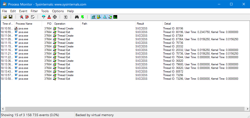

I made a bit of investigation. I ran Process Monitor because I thought that these "glitches" happen because maybe Heli-X loads some files, like sounds or whatever. Especially because they happen more often right after you start it, and it gets more stable after a couple of minutes.
I didn't find any of that, but anytime a "glitch" (it freezes for a couple of frames) happened, there was "Thread Create" operation logged in Process Monitor.
Not every "Thread Create" resulted in a freeze. But every freeze resulted in "Thread Create" being logged.
is it maybe Java garbage collection triggering?

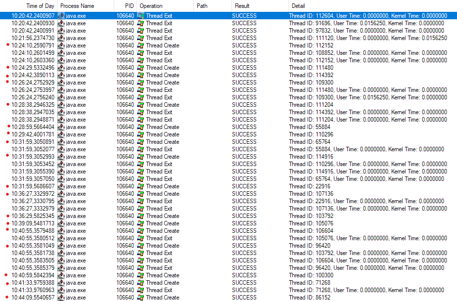

First of all, this is how it looks over time, just to have idea how often things happen. Every "Thread Create" was connected to FPS drop.

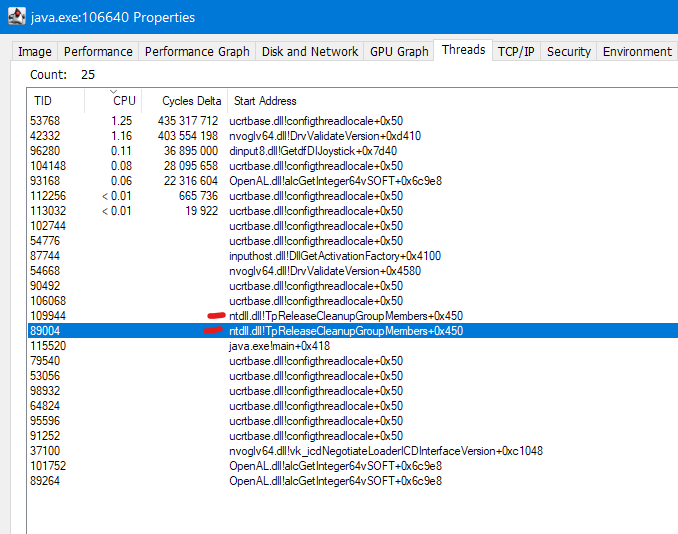

I was able to record thread activity and it seems anytime this happens, there's thread creation / destroying around these two:
If I suspend these threads, it seems problem is gone. I will test over time, but I was running Heli-X for 15 minutes with no FPS drop and no new "Thread Created" events in process monitor. And before it never happened that it would run 5 minutes without a problem.

Not a lot of new knowledge, but I can say now with confidence that suspending "TpReleaseCleanupGroupMembers" threads on Heli-X makes Heli-X run smooth.
Also, what this function is doing is release a thread pool (Tp = thread pool).
I haven't found a way to automate this yet, so I do this manually anytime I start Heli-X.
Why would the process release a thread pool every couple of minutes - this looks wrong. Not sure if it's a problem in Java, or some library, no idea.
