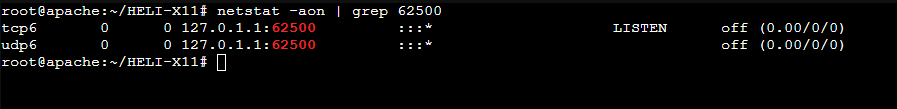

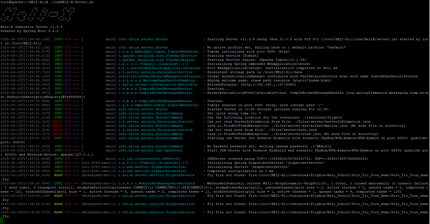

Actually run into problems with hosting a server with linux.
I can not connect from external on port 62500.
Message: "Verbindung zum Server kann nicht hergestellt werden"
Port forwarding from external 62500 to internal server 62500 is working on UDP and TCP. Tested with Telnet.
If I start the version 11 server, the binding of port 62500 is wrong? See attached file../Java/jre21/bin/java -DServer.port=8080 -DAllowedOrigins=http://192.168.1.127:8080 -jar "$JARPATH" -d helix.xxxx.xx --enableRemoteShutdown --name "Session" --password mypassword -t SkyBox -s SkyBox/MVA-Almere/MVA-Almere --dataDir ./files/server --resources ./resources/flights
