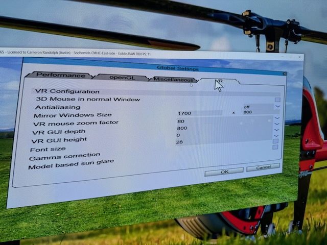

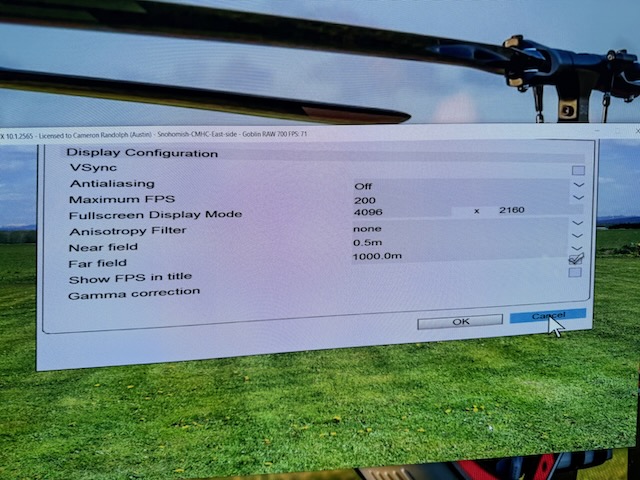

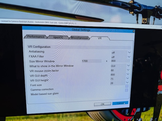

On my V10 VR the model is 'bigger' on the (VR Goggle) screen than with V11 VR (using the same VR headset - Meta Quest 3).
All my screen settings are the same between versions (see screen shots).
QUESTION: What do I need to do to make the model larger on V11 VR?

Re: VR Model Size on screen - difference between V10 and V11
Posted: 25 May 2025 22:00
by admin
the only cause I can imagine is the Miscellaneous-object zoom, which works both on VR and non-VR.
