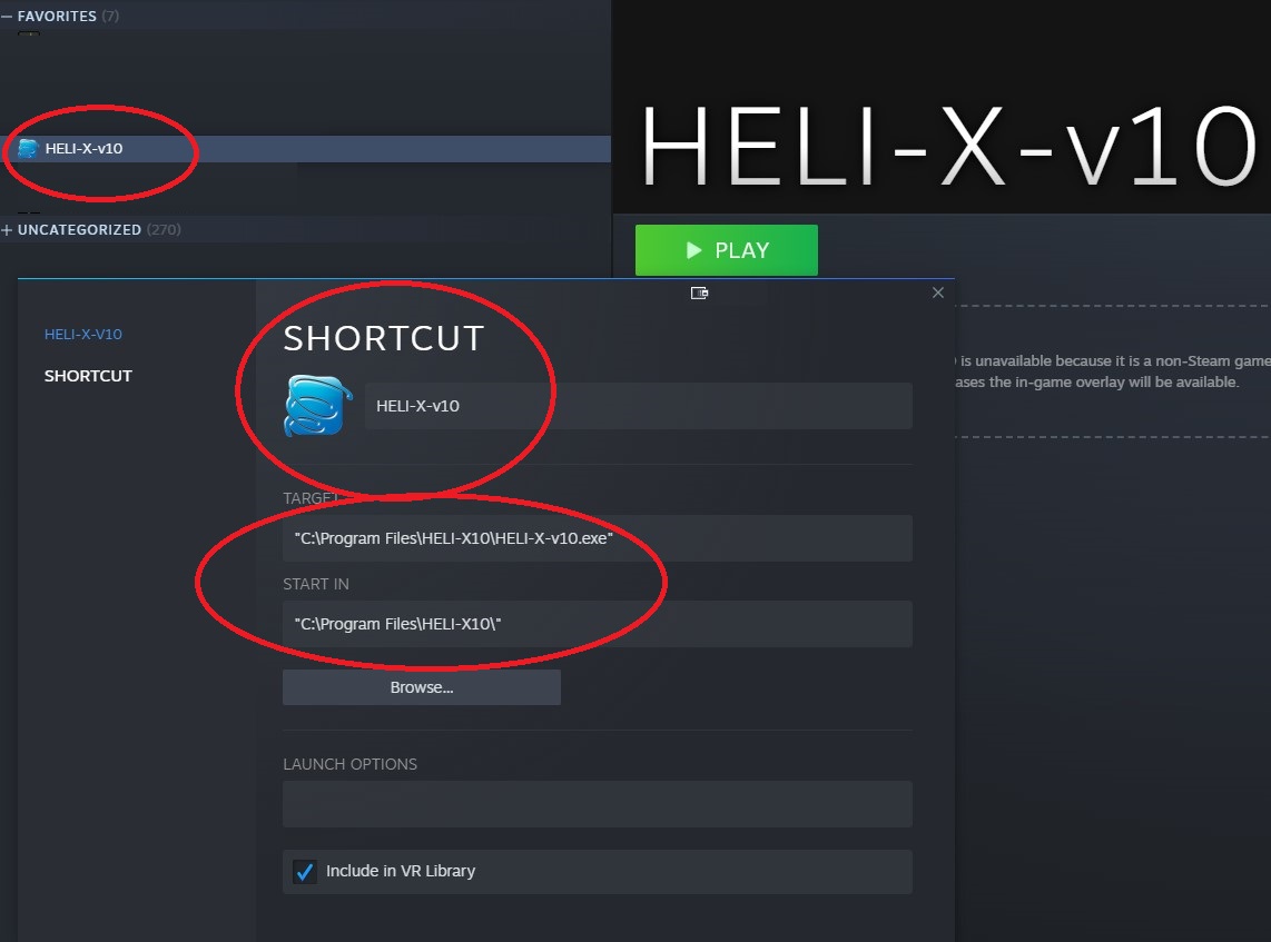

So i just used this script == link below
Create a batch file with that script \ copy pasted, You drag the run-HeliX bat file onto it .. it creates the EXE
Add the EXE to steam as non-steam game as normal method.
I changed the iccon to the heli-X.ico file from the simulator install directory.
Run the game from steam - steam link it.
