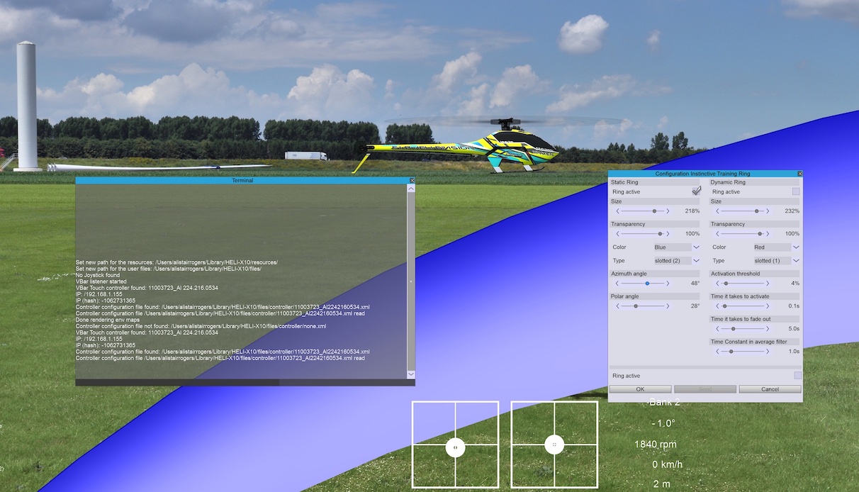

Hi. I found a couple of things.
1. In the Ring configuration window, the ring is visible. But it is not centered on the Heli. So depending on how the sliders are set you might never see it. Even if I check the ring active boxes it does not stay displayed when I exit the configuration window. No errors in Terminal. Please see attached screenshot.
2. The menu item View > Show Augie's Ring appears to do nothing. It does not display the ring and no blue dot appears.
3. If I select View > Flight Path Configuration, the ring is displayed while the config window is open. But when the window is closed the ring disappears again. (The ring is always displayed when this configuration window is open. It does not change if I try to change the state of display ring from the View menu.)
4. If I select Exit Heli-X, the ring is displayed while the exit yes / no window is displayed.

- Attachments
- Ring Config 2022-01-23.jpg (250.34 KiB) Viewed 71245 times
