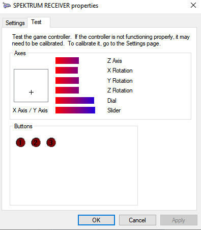

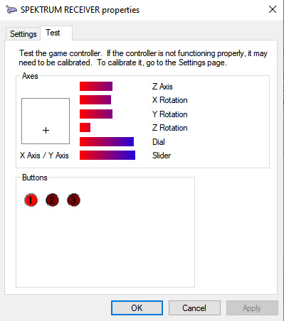

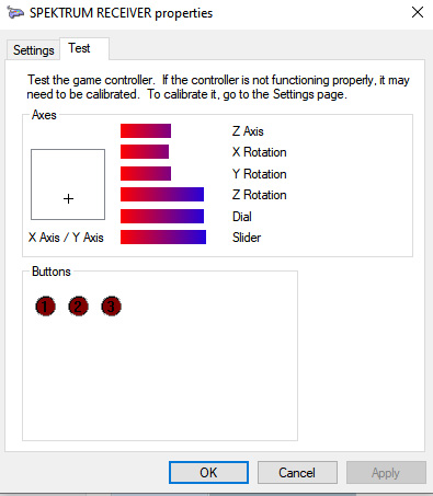

FWIW, below are the the mapping on Windows 10 game controller of the Flight Mode switch...
IU1:
IU2:
IU3
Note that button 1 (recognized by Hel-X10) only switches off or on between IU2 (off) and IU3 (on) positions. IU1 and IU2 are both off. What changes in all three modes is the z-Rotation... Not mapped in Heli-X10.

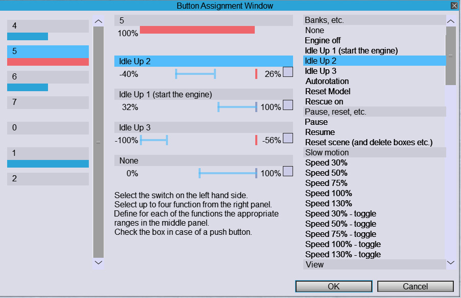

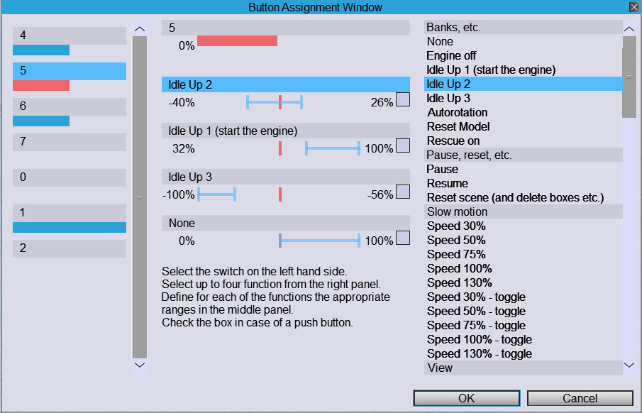

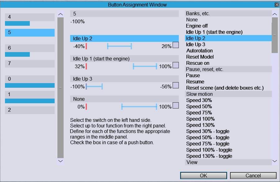

The issue was resolved by also moving the switches/button (3 position Flight Mode, Throttle Hold, and Bind button) on the dialog page that asks to move the collective/rudder and cyclic sticks to get them recognized. Once that is done, I had to program the switches as follows (after first deleting the SPEKTRUMRECEIVER.xml file from the Windows C:\ProgramData\HELI-X10\files\controller directory):
IU1, Switch 5 (Flight Mode) at 100%
IU2, Switch 5 (Flight Mode) at 0%
IU3, Switch 5 (Flight Mode) at -100%
