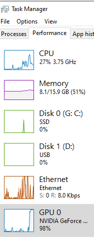

Sometimes when I start Heli-X my GPU maxes out with the helicopter just sitting on the ground. If I try to fly it is way too choppy. A reboot usually clears this up but wondering what else I might be able to check? v 9.2.2400
Screenshot 2021-09-10 151639.png (19.37 KiB) Viewed 16852 times

you can try to limit the FPS in the global options in HELI-X.

I lowered all the way to 25 and it doesn't help. It seems this problem is only when the Helix window gets to a certain size. I took a quick video of whats happening. https://youtu.be/eb6zy3I8XjU

A new GPU solved all of this.. Thanks.
